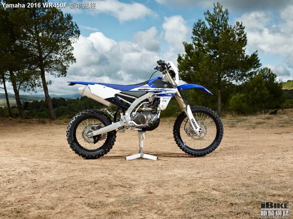

Yamaha 2016 WR450F全車內外經過多項提升及改良,應用了Yamaha MXGP世界冠軍戰車YZ450F大量最新製作技術,令WR450F變得前所未有的強。450cc水冷DOHC電噴引擎,注重扭力輸出。創新的引擎設計,進氣閥在前方,令盤頂擺放位置和傳統引擎剛好相反。營造出低重心和緊湊的車體設計。透過額外購買的Yamaha Power Tuner,引擎出力特性可以隨意調較而無需接駁電腦。
頭尾避震設定以林道為主,頭叉採用KYB油/氣分離AOS技術,提升穩定的操控感。輕量化的極力子讓操控變得更省力。闊齒輪比的五速波箱更適合行街及應付不同速度。WR450F散熱水箱有風扇,慢車都唔驚。配備電撻和頭尾燈組件。錶板上也有燃油存量提示燈。所有WR450F都配上象牌6 Days極限越野輪胎。

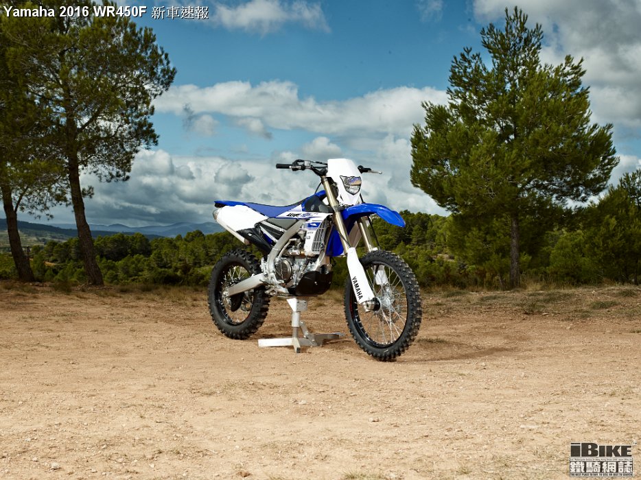

2016 WR450F Model Overview

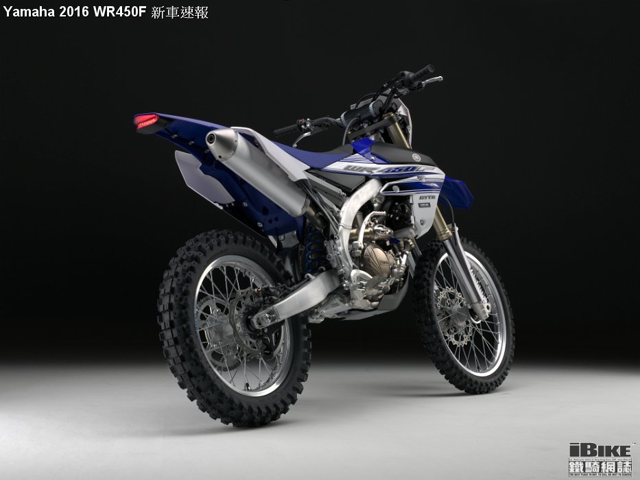

• All-new enduro / rally model benefitting from the latest Yamaha technologies
• Aggressive and modern YZ450F-inspired 'Rightfully wrong' design concept
• Industry-leading ‘reverse’ engine layout
• Compact, mass centralised design delivers light and agile handling feel
• Linear torque for easy to control engine performance
• Enduro suspension settings give stable and confident handling feeling
• MXGP World Championship winning DNA
• Competitive price

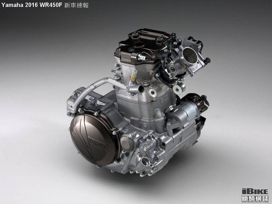

•YZ450F-based 450cc liquid-cooled DOHC, fuel-injected 4-valve engine
•Revolutionary reverse cylinder head with front facing intake
•Engine behaviour is fully adjustable with optional Yamaha Power Tuner

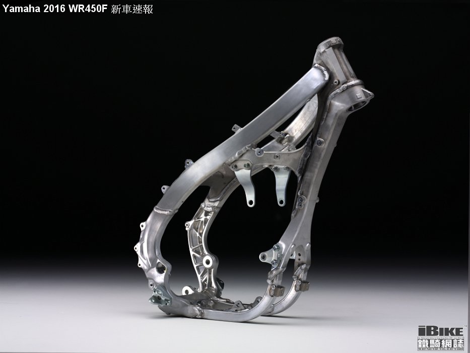

•YZ-F based aluminium bilateral-beam frame with optimised rigidity balance

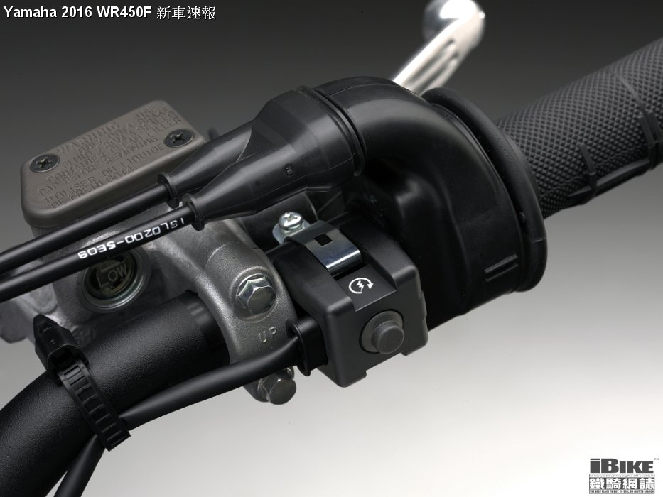

•Main switch-free electric starter

Linear torque with deep reserves of power.  Like the YZ-F models and the recently launched WR250F, the completely new WR450F engine features a reverse cylinder head with a front facing air intake and rear-exiting exhaust. By increasing intake and exhaust efficiency, this innovative layout enhances the engine's linear torque feeling, and delivers deep reserves of highly controllable and easy-to-use power.
Dubbed the 'Rightfully wrong' concept by Yamaha, the WR450F's reverse cylinder head and rearwards-slanting cylinder layout has already proved its competitiveness with the World Championship winning YZ450F motocrosser. As with the highly successful YZ-F 'brothers' and the WR250F enduro, the new WR450F's compact engine layout - together with the underseat fuel tank and snaking exhaust pipe - contributes significantly towards mass centralisation.
Like many innovative technologies, the look of the reverse cylinder head may initially seem 'wrong' to some, but with its inherent performance gains, together with its more focused mass centralisation that deliver lighter and more agile handling, this is the right way forward for riders who demand winning performance combined with enhanced rideability.

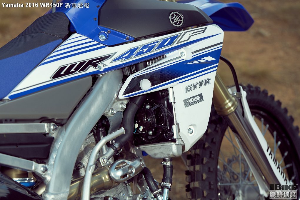

Enduro-spec radiators with lightweight cooling fan
For effective cooling performance in all riding conditions, the WR450F is fitted with new enduro-specification radiators that feature a different core pitch angle to the YZ-F design, and the new shrouds have also been specially developed to suit the special demands of enduros and long distance rallies.
To ensure good cooling performance at low speeds, the WR450F is equipped with a radiator fan as standard, a feature that will be appreciated by any rider who has ever been stuck in a bog or been waiting in a long line of riders at a particularly tricky obstacle.

Starting the WR450F on a cold day - or restarting a hot engine - is made easy with the newly designed electric starter. A new auto-decompressor system cuts in when the electric start is activated for easy starting, and the air supply to the engine can be increased by 40% by for reliable cold starting. If for any reason the electric starter cannot be used, the WR450F is equipped with a kick-starter.

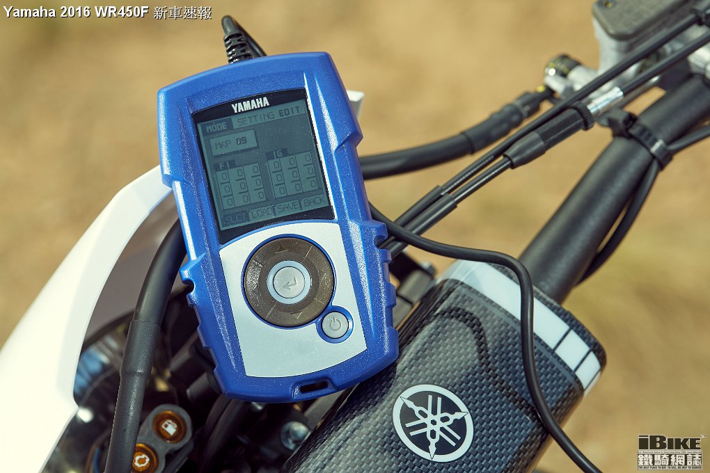

Optional Yamaha Power Tuner
The Yamaha Power Tuner is a compact and easy to use electronic device that enables WR450F riders to adjust the engine's power characteristics at the trackside to suit prevailing conditions. Riders have a choice of nine easy to program adjustments for the fuel and ignition maps, and there is also a monitor function that allows the user to adjust idle speed and see total engine running time.
Powered by two AA batteries, this palm-sized device requires no downloading prior to use, and is designed to plug straight in to the WR450F without the need of a PC.

Compact size with centralised mass.  The configuration of the new rearwards slanting engine has enabled Yamaha's designers to construct a compact new chassis that capitalises on the handling performance gains offered by the engine's more centralised mass.
Developed from the design used on the latest YZ450F, the aluminium bilateral beam frame runs with sophisticated front and rear suspension systems that deliver light and agile handling performance. The highly versatile and easy to ride character of the new chassis complements the strong and controllable linear torque feeling of the new engine, enabling the WR450F rider to exploit the bike's full potential.
In order to give the enduro rider improved levels of feedback and a more connected feel with the terrain, the upper and front engine brackets are manufactured from 6mm thick steel plate, 2mm less than used on the YZ450F motocross model.

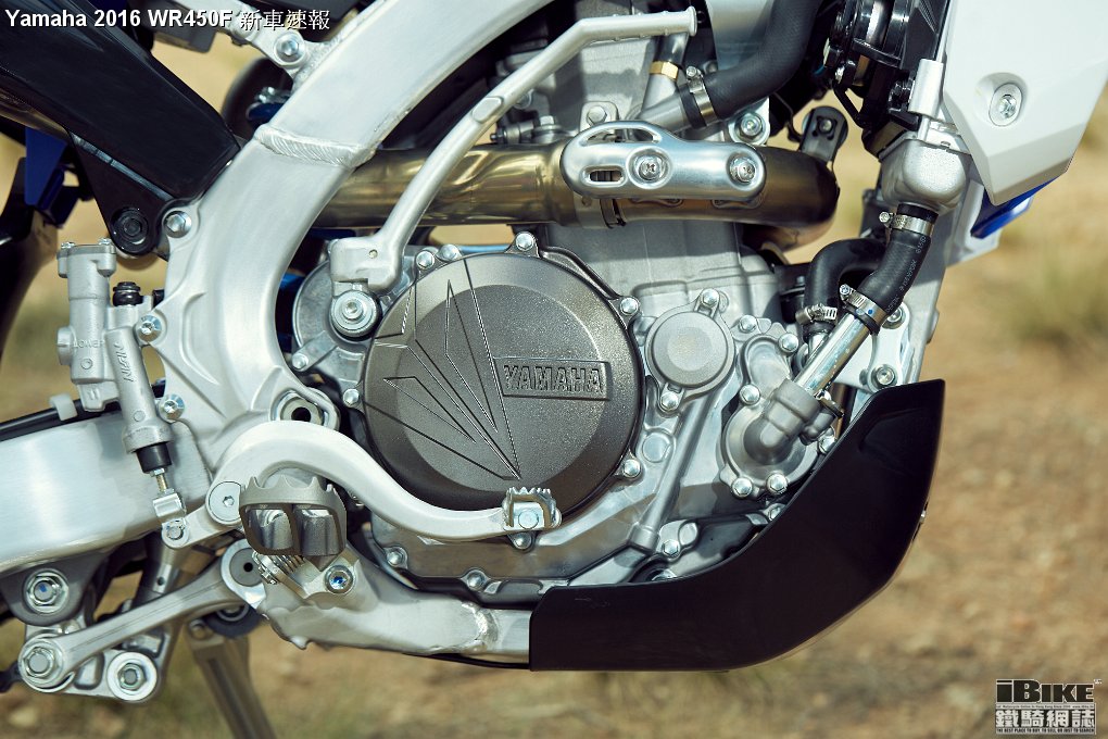

Featuring black rims, the WR450F's 18-inch rear wheel and 21-inch front wheel are equipped with Metzeler 6 Days Extreme tyres, and the enduro equipment also includes a lightweight engine guard, frame-mounted side stand, sealed chain and 22mm rear axle.

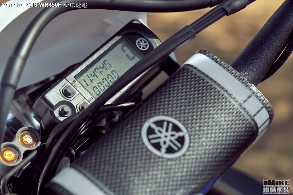

Lighting and instruments

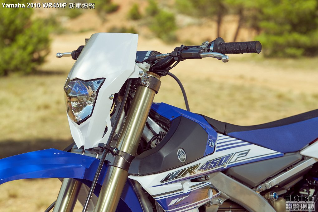

The WR450F is equipped with a full lighting kit, and to handle the extra demand on the electrical system, a high output ACM is fitted. The lightweight digital instruments include a multi-function display with an enduro computer that keeps the rider informed about their progress and distance covered - while a fuel level warning lets the rider know when it's time to refuel. There's also a main switch-free starting system for speed and convenience.
